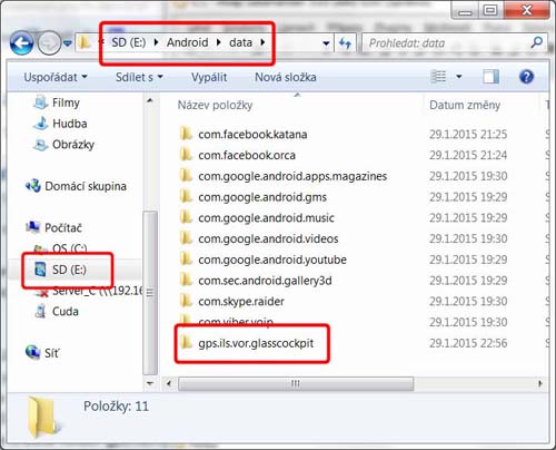

Edititng your SD card at your PC using Explorer.

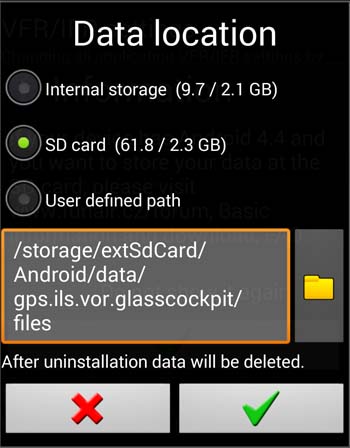

FLY is FUN (Preferences/General settings/Data location)
