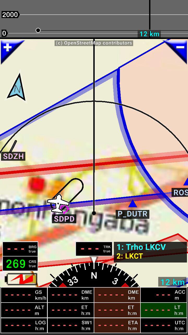

I attached also PatternsUTF.txt (it is zipped), try it with wersion 19.82, it should be OK.
Anyway line AN should be (code first):
SDPD;AN Orbita-1;06/24

Sorry. It did not work. Same behaviour, but now I know why.
I compared the file you sent me with the one I created here.
Since I use Linux, each line in my file end with line feed (0x0A) only.
Each line in your file ended with carriage return+line feed (0x0D+0x0A).
I changed my lines endings and everything went fine.
I hope this helps you to kill this bug.
