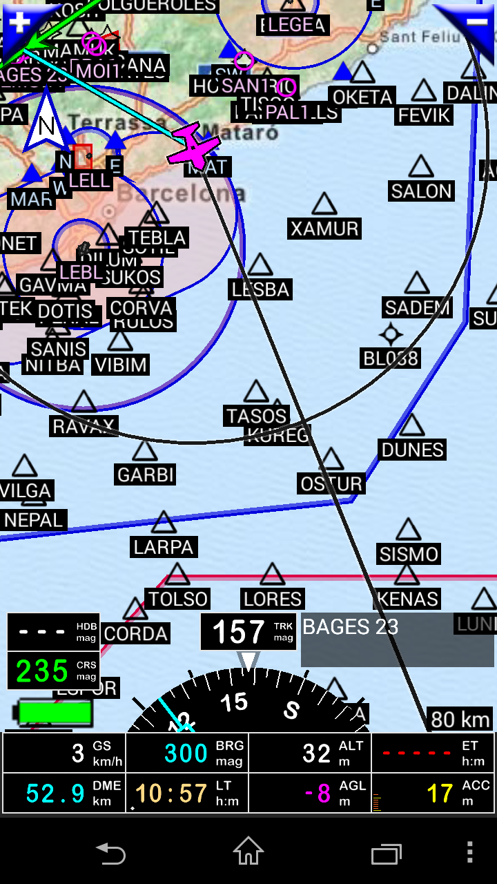

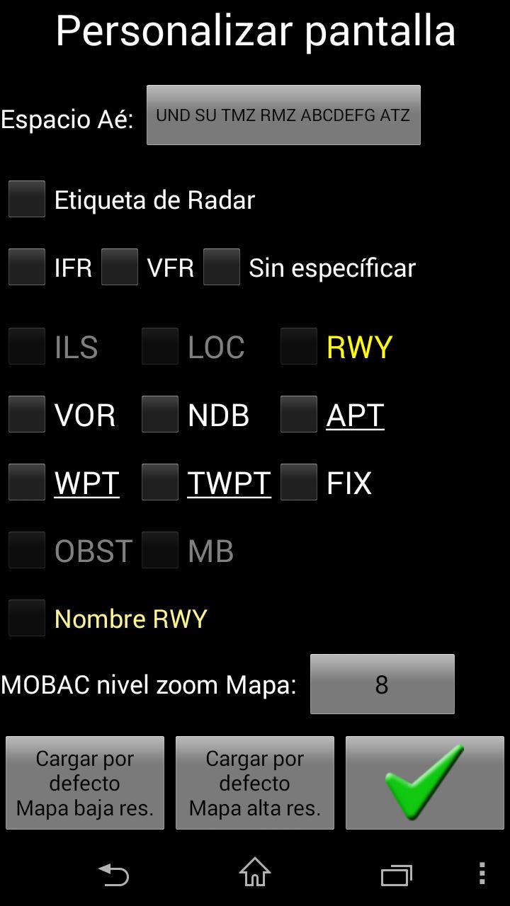

Postby Eliseo » 07 Jan 2015, 10:21
In Spain all codes beginning in LE
are AD, the rest are generally ULMs,
no with service and no service.
Another question.
I understand that unchecked it should not be anything on the screen, does it?
Eliseo

1. Did you do for zoom 80km (which you displayed)?
2. Try Customize screen and uncheck Force displaying all user defined items.

Postby Eliseo » 09 Jan 2015, 12:34
Hello.
This issue took him almost a year, may be what I not explain very well matter for english language, I try one last time, and I will wait for someone smarter than my and he better explain it.
All display settings are to uncheck Force displaying all user defined items.
The problem are in all zooms.
1 - I understand that if no framework anything in the boxes should not see anything on the screen.
2 - Why I see IFR points if when I do donwload it under only VFR?.
3 - The APT as "moi1" "pal1" etc. this fields are ultralight, and I think have to appear on screen when the box is checked ultralight.
Best regards :)
Edit.- Sorry the number 2 is an error, I only donwload: Airspaces, WPTs, Airports.
Eliseo
Posts: 41
Joined: 13 Apr 2012, 11:13
Re: Map decluttering
Postby kitercuda » 09 Jan 2015, 16:37
This is an issue. When you uncheck all, all is displayed :D
I will repair it...
Postby Eliseo » 13 Jan 2015, 11:05
You managed to solve part of the problem, but I think you should check your database, which I mentioned in the previous post,.
I tell you to improve implementation, I think it is a major improvement.
One more thing.
You should check "unspecified" ... it means? if you turn it off then nothing appears on the screen. :) :)
