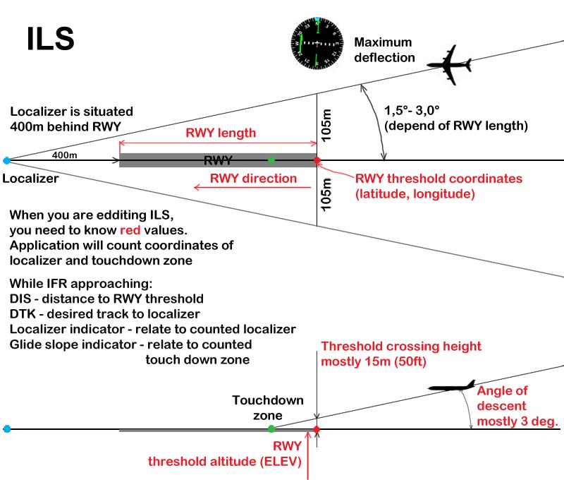

It is possible to have more ILS scales and make it less sensitive? In short final of the glide slope path is suddenly very nervous going up and down, in other words make wider the cone approximation.

I do not konw - I will thing about it, because application try to simulate real ILS. Max deflection of GS and LOC are given...
Look at the picture.

What GS angle are u already using?

I understand.
In my ULM field the is a electric tower I need 4º or 4.5 º.

Version 10.4 have always maximal Glide sloppe angle deflection 0.72 degree. Then GS indicator was out of range. So in range was GS angle from 2,28 till 3,72 degree.
Version 10.5 will have max. "in range" glide slope angle deflection 0.24*GS angle.
So if GS angle is:
- 3 degrees - max "in range" deflection is 0.72 up or down
- 4 degrees - max "in range" deflection is 0.96 up or down
- 5 degrees - max "in range" deflection is 1,20 up or down
etc.
This settings is like real ILS.
