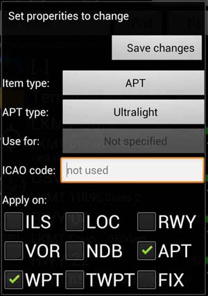

Is there a way to edit data to a group of waypoint at the same time??

1. You can export them in internal or KML format
Long tap at the folder which you want to export and select Export or open folder and press Menu/Export
2. Group editing: Long tap at the folder which contains nav items which you want to edit and select Change all items inside. This option is improved in version 10.80 (will be available until the end of this week)

I imported a gpx file with many (2700) waypoints. They do appear in the maps and everything works fine. Then I changed all at once from wpt -> apt using the long tap options on their directory. After that, they take a long time to list when i want to select one, and sometimes the code crash. It stuck with the message "filling list box". This operation is very fast in other folders with comparable number of items.

Postby kitercuda » 20 Jul 2013, 08:33
Please, can you send me your files.
When you have a lot of APT in one folder, there can be problem with long filling :-(.
When filling list box, application checks each APT, if exists VHF (in the VHF table) for this item. It is the same as TWPT.
