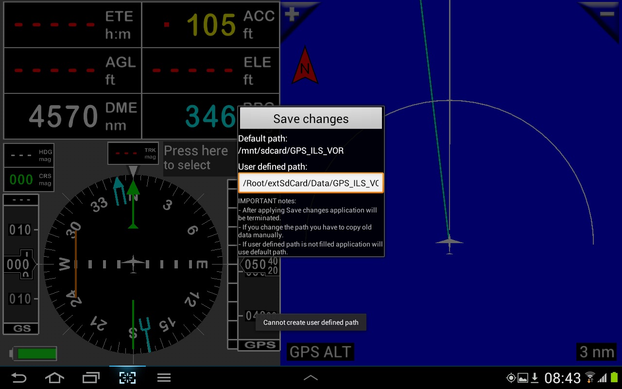

Cant seem to find a way to select the external SD card
Any Help?
No luck
Tried both /storage/ and /Root/
Any sugestions

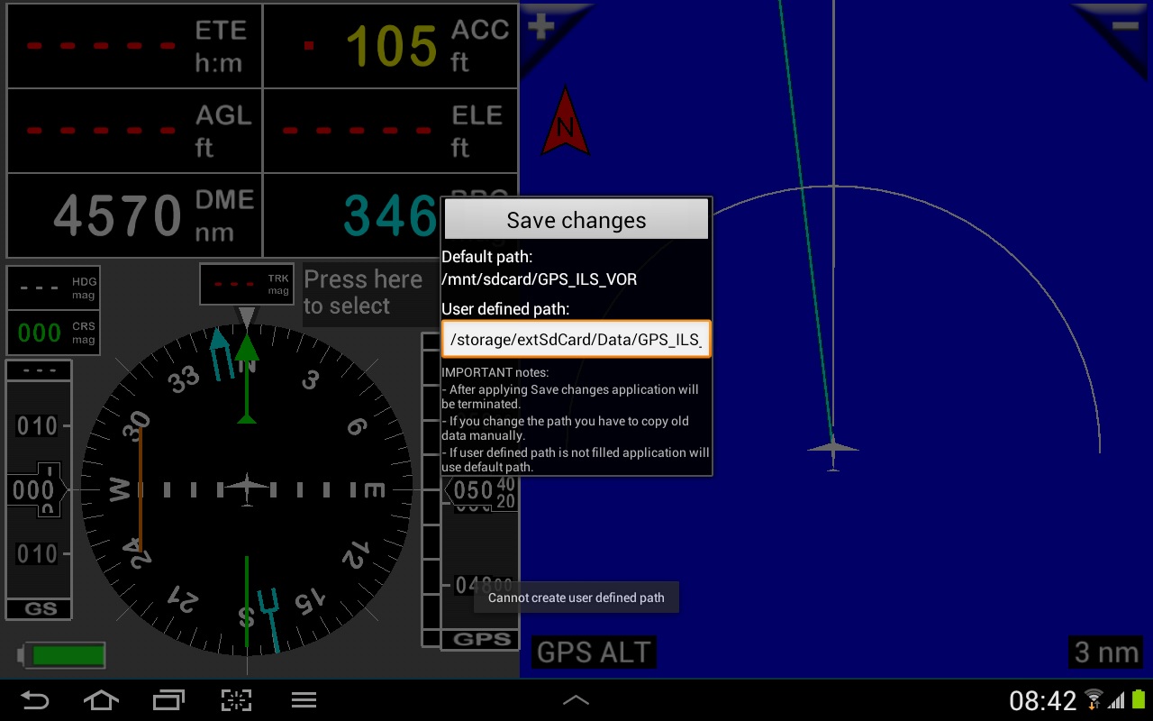

I use for exame on my Samsung Galaxy S4 this:
/storage/extSdCard/FLYisFUN
And it is working
I am having some issues with the data directory on the TAB
There seems to be an internal sdCard that is to small
I have added an external sd card but I don’t seem to be able to define a path to it
I have tried /mnt/extsdcard/GPS_ILS_VOR but get message ” cannot create user defined path “
Any ideas?

I tried it on Samsung Galaxy Note 10.1, used /storage/extSdCard/FlyIsFun/ and it is working...

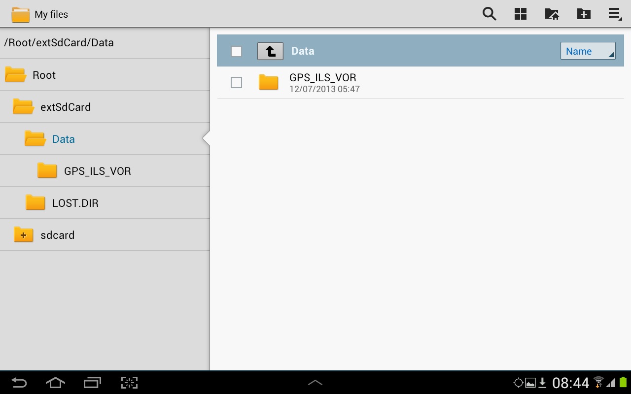

Try this:
- Install ES file explorer
- launch ES file explorer
- switch to external SD card
- Create folder (for example FlyIsFun)
- Tap (open) it
- Look at the history of opened folder and you will see full path

Works now
on the ext SD Card I created the folder Data and in the Data folder I created a folder GPS_ILS_VOR
The path then is /mnt/extSdCard/Data/GPS_ILS_VOR/
