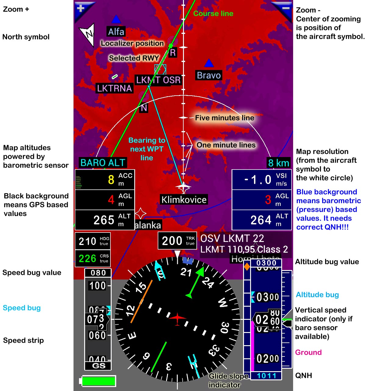

very great program..!
Anyway,
I did some route and tried to fly along it in simulator mode.
I can see a green line comes from anywhere and goes to anywhere.....normal ?
I tried to intercept the course to the bearing of the waypoints.....hmmmm...?
Maybe I am on a "wrong side"? :roll:
Thanks for assistance.

Green line is the course line of selected nav aid (or WPT)
(Course direction is set automatically, but it is possible to set it)

:shock:
Oh man what a professional I am-----this green line is the projection of
the course needle in the indicator....I see
Thanks for assistance,
Next time I should read your application more carefully... ;)

I have been trying this app for few weeks as a trial version.
This green line through whole map is quite annoying for me during real flight. Is there any way how to hide this indicator? I went through settings, but I didnt find any.
Thanx for answer.
Jan

Hi Topgun :-)
It is very easy.
- cutomize screen (long tap the compass rose)
- Press CRS color buttons
- Set alpha to zero.
I hope flying will be much more pleasure ;-)

Thanx,
it seems it s working (in sim mode now, i will try it in real flight soon).
