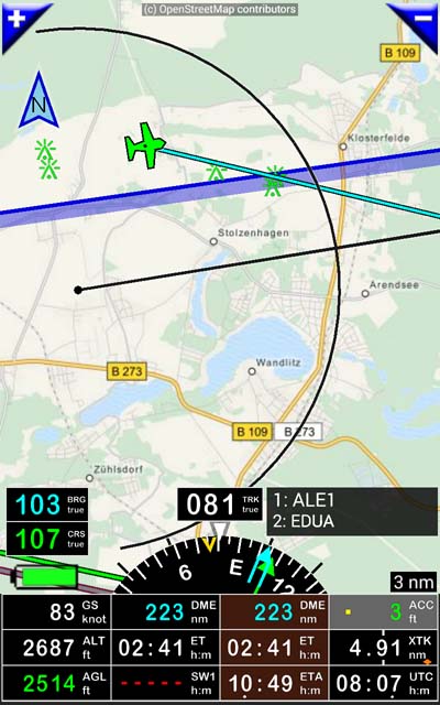

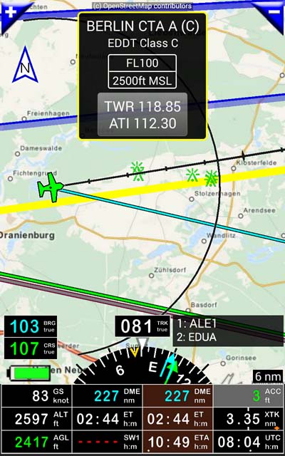

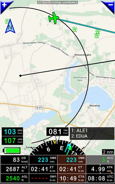

3.) (In simulator mode!) when going along airspace C2500MSL north of Berlin it disappeared when zooming in (see screenshots attached - wrong order though-, same with range 1NM but only 3 attachments allowed). This was NOT due to screen customization for zooms!

3. This is e problem of data source. WPTs of airspace must be polygon. If it is 8 (means the lines of one aircpase are crossed) it makes thsi problems. I try to analyze airspace before its displaying.

3.) For now I don't understand why 8 means crossed but guess it probably might be as with creating your own airspaces, patterns etc.
