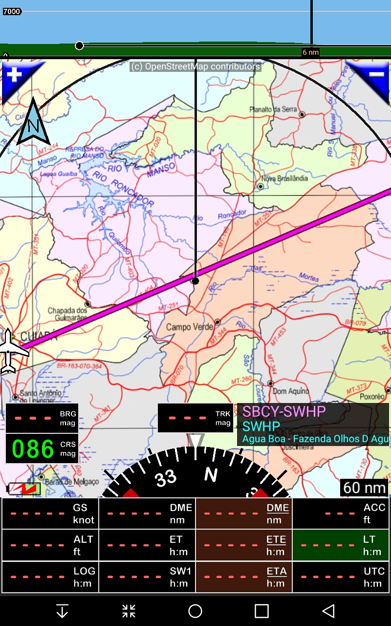

Hello!
I have my IFR charts georeferenced through MapTiler, does anyone know how to convert them to Fly is fun?
What other program would do georeferencing from PFD image? (For Fly is fun)

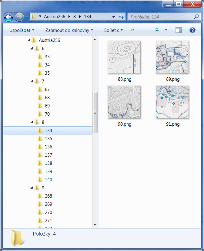

Is it possible to convert your maps to format, where tiles are in folders?
If yes, it is possible to import them to FIF:
- Menu / downloads / Topo maps
- Menu / Import / Slippy Mercator...

kitercuda wrote:Is it possible to convert your maps to format, where tiles are in folders?
I did as you instructed, FIF imported and converted to .sqlitedb format, but when displaying the map does not appear ... I think I'm pretty close to solving this, if you have more guidance I appreciate it.
LaelNeves
Posts: 12
Joined: 16 Jun 2017, 03:29
Re: IFR Chart georeferenced
Postby LaelNeves » 09 Jul 2017, 00:18
I'm happy! I got it and everything went fine, thanks for the guidance and patience with me !!
