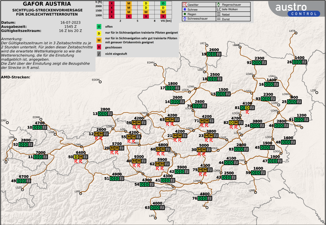

is it possible to view Austria Gafor routes in FIF ?

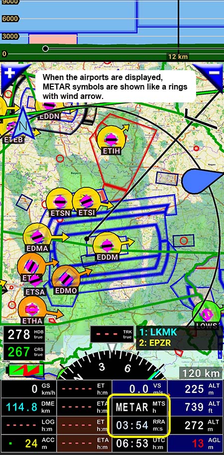

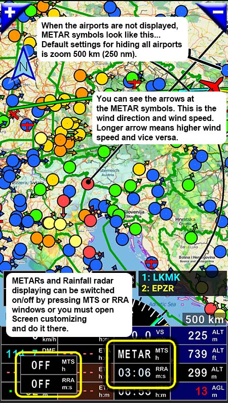

You do not need GAFOR with FIF. I think more precise are METARs and TAFs.
To switch between METAR and TAFs, only click (MTS - METAR TAF Switcher). There is a loop METAR, TAF + 1h, TAF + 2h, ..., TAF + 9h, OFF. You can also long-press it to switch it off quickly.

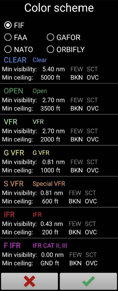

If you like GAFOR, you can switch to GAFOR color scheme, but I do not recomend it, because the FIF colour scheme respects the aviation rules.
For example if you see blue or green you can VFR flight without restriction.
If you see yellow or orange, you can fly VFR flight with some restriction (special VFR flight)
Red and purple is for IFR flights only.

I rather mean the path - route, not weather.
