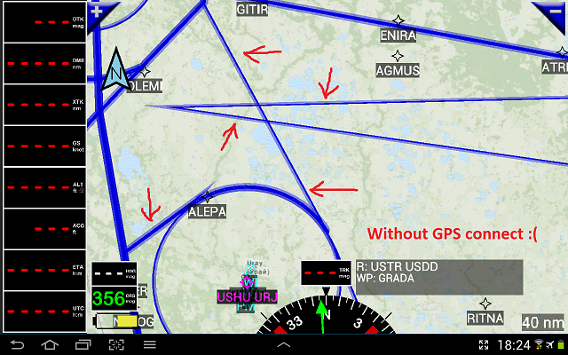

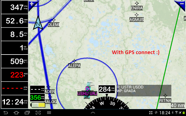

Postby FriendSky » 11 Mar 2013, 08:33
This is a bug or not ?

Postby grayint3 » 12 Mar 2013, 17:00
This is not a bug. Then you use a GPS you have an altitude and application hides airzones that higher and lower your position. When GPS is off application displays all airzones. You can find this info in the Manual.
