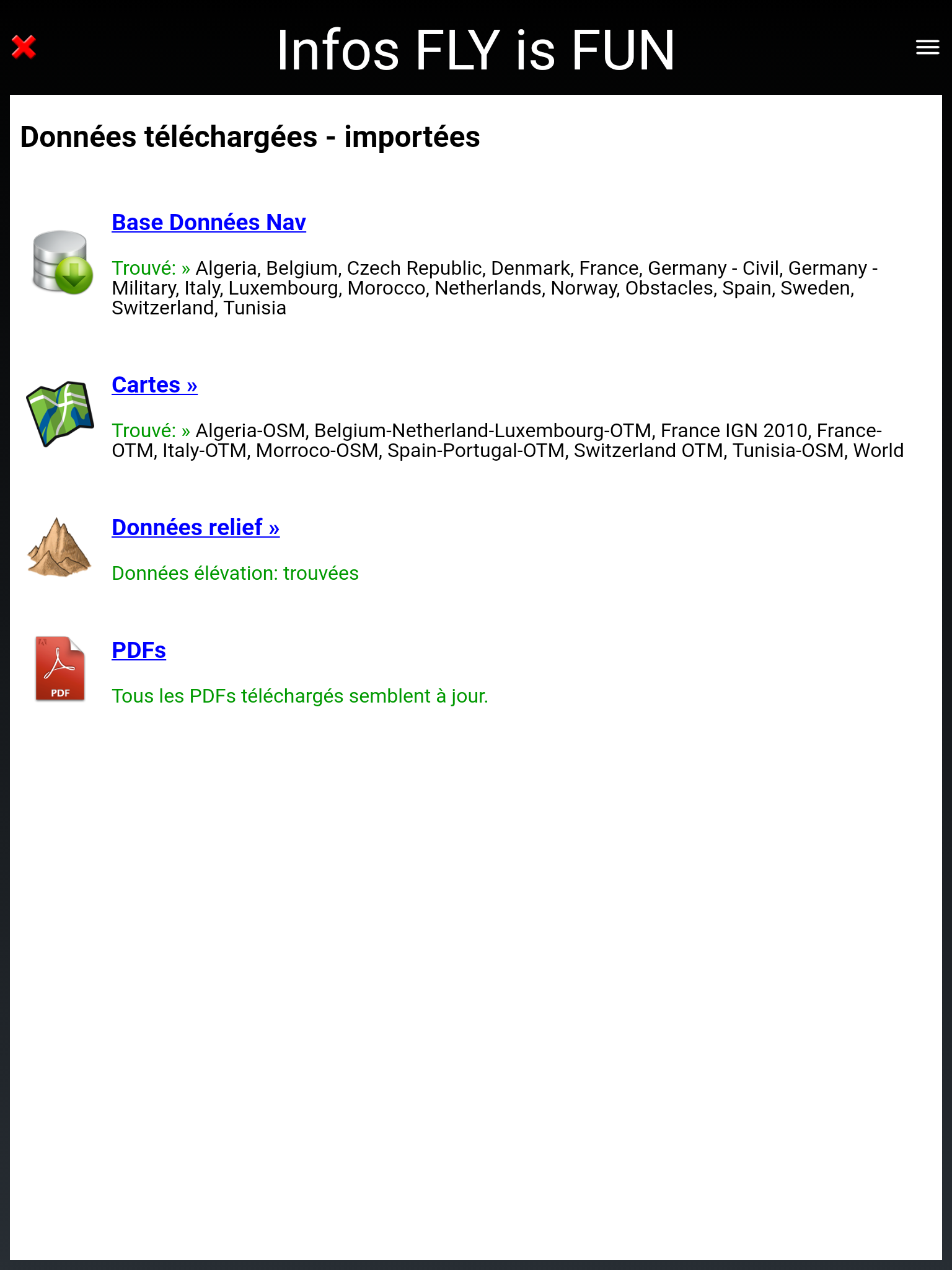

Postby Tonio » 02 Oct 2017, 17:35
May be, together with thee poor internet connection you described, you had storage problem.
Did you check free available capacity
This, as I have no problem downloading data for countries from Sweden until Tunisia, c.f. attached image
