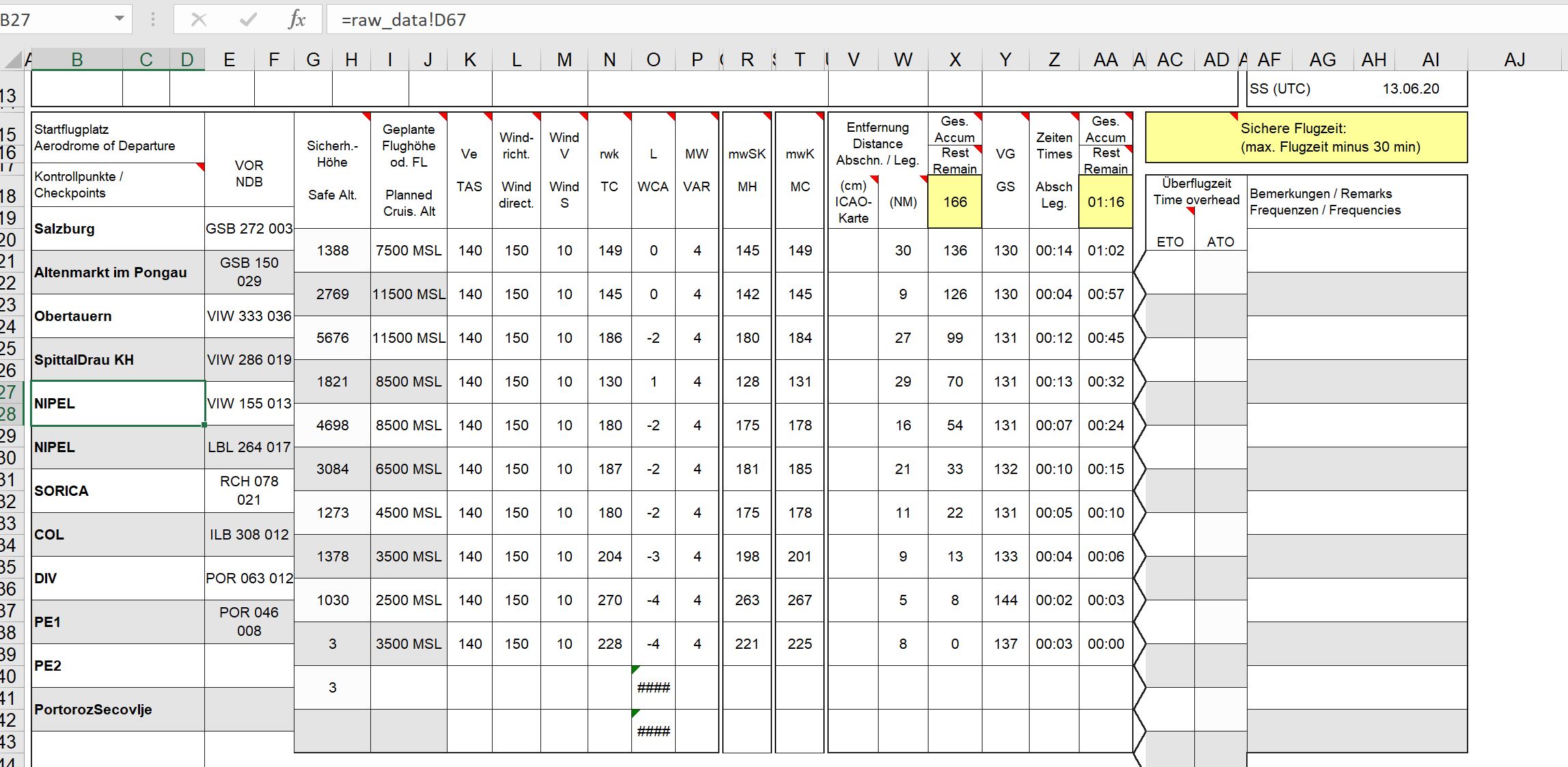

I have a problem with the fligthlog XLS export. When entering an airport enroute (I just suspect that could be the reason), I get two waypoints in may XLS flightlog, although there is just one in the flightlog/route. I have an example, but the upload function does not allow xls/gir files to be uploaded, maybe someone can help me, what´s wrong,

I do not understan your problem. Can you describe it more or attach some screenshot?

Of course, in the attached Flightlog Waypoint Nipel is only one waypoint in the route, but in the Flightlog it has two entries with distance and tracks between the same waypoint - to correct the error, I just manually delete the double waypoint (the second one) and move the other waypoints one up - then everything looks correct. I have this error on many flightplans, so it should be easy to replicate the error,

Hi Dominik
Did you try using other xls log templates?
If yes, have you the same problem?
If you don't have the same problem, it could be a simple mistake in the xls template.
If it's the case, it's easy to solve
Best regards
Re: XLS Flightlog double Waypoint entry
Postby Tonio » 16 Jun 2020, 09:05
Hi Dominik
Having checked this morning, it seem that FIF export to the xls log is correct,
You can see FIF exported data are in the "raw_data" sheet
Apparently in column E the "Vorderseite VFR Durchführungspl", their is a mistake
2 different cells are pointing on the same cell of the raw data sheet
