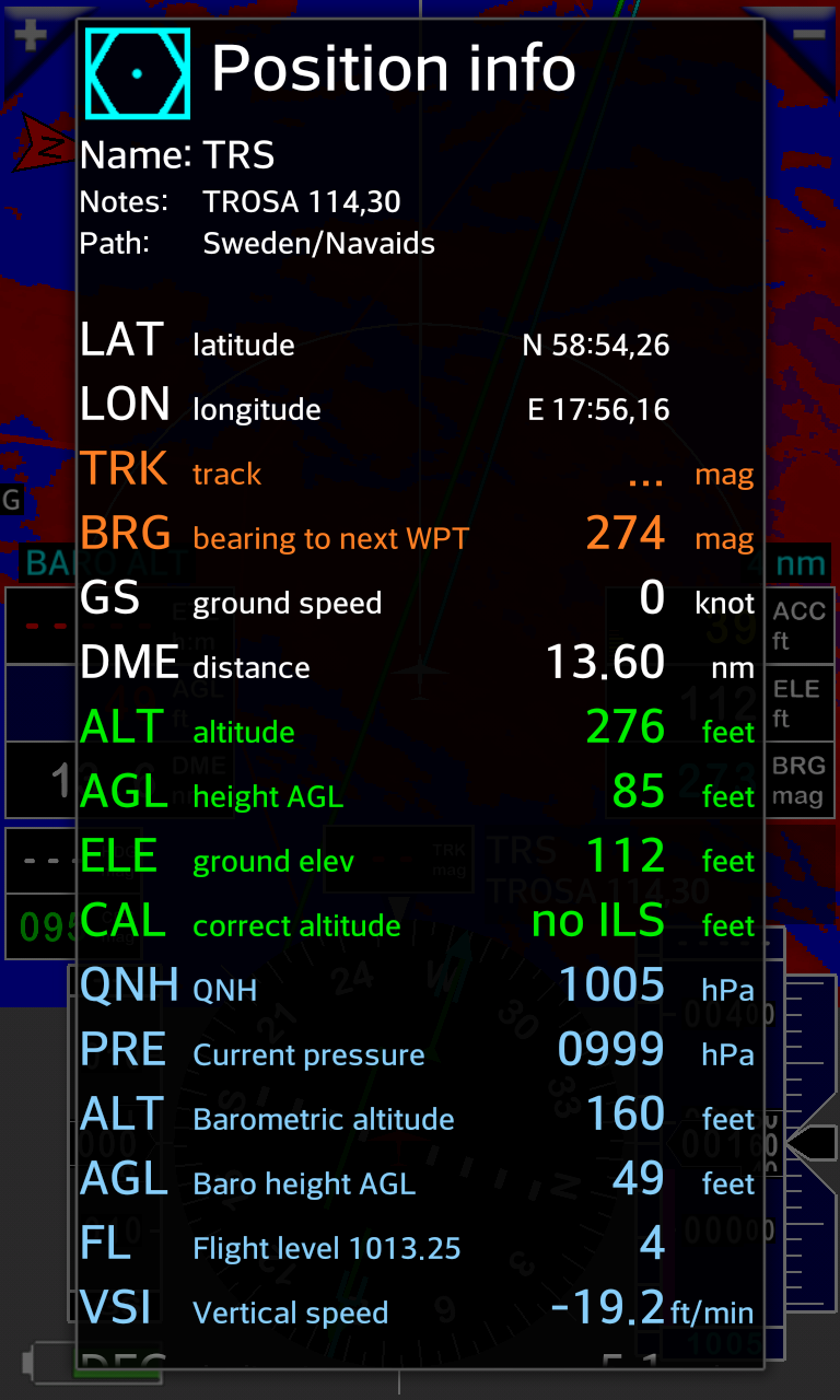

The GPS calculated AGL value seems odd, 276-112=85?
Also the GPS altitude is off by about 100 feet. It is much more accurate in other GPS apps om my device.
Barometric AGL and ALT makes sense. I walked down to the sea and it read a couple of feet with QNH set from my closest airport. (My home is just by the sea).

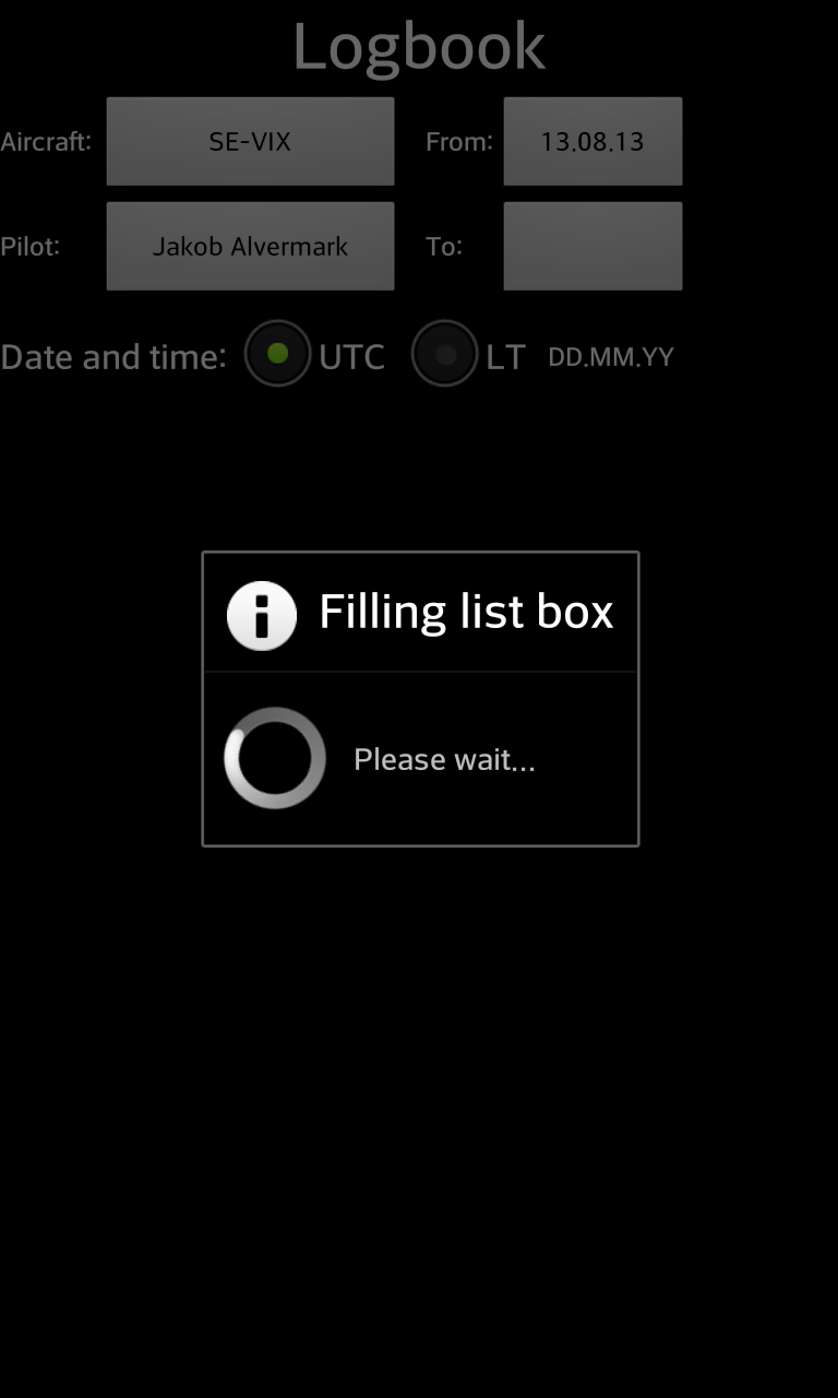

When opening the logbook the app hangs showing the "Filling list box" dialogue.

GPS altitude is much more accurate than other application, because application corrects raw GPS altitude about geoid altitude (GPS shows WGS84 elipsoid model altitude, but real geoid is not ellipsoid and difference can be more than 300ft). Altitude in Position info was raw GPS altitude, but AGL was counted from corrected GPS altitude...
Repaired :-)
I tried to open Logbook, but without any problem. Can you described me more, what you do, that your application hangs?

kitercuda wrote:I tried to open Logbook, but without any problem. Can you described me more, what you do, that your application hangs?
I open the logbook, and when I select a date (either from or to), it gets stuck, with the spinning "Please wait..." box.

Please can you send me logbook.db file? it is in floder GPS_ILS_VOR/Database.

kitercuda wrote:Please can you send me logbook.db file? it is in floder GPS_ILS_VOR/Database.
Sent!
