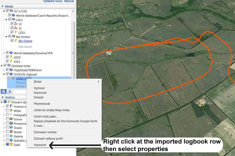

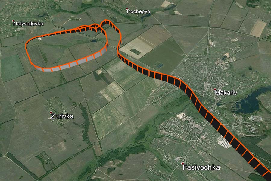

Postby kitercuda » 07 Oct 2013, 12:51
Btw:
When you export flight track to KML and import to Google Earth, you can see this:

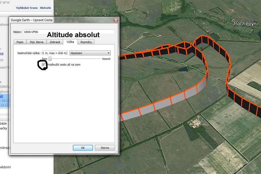

Postby kitercuda » 07 Oct 2013, 14:49
How to display your track in Google Earth:
