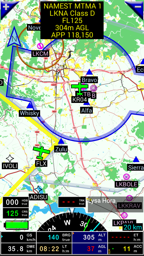

Postby kitercuda » 19 Jan 2014, 07:54
Look at the picture :-)
It is working - beta version. We are trying to add some ADS-B network, communicating with owners...
