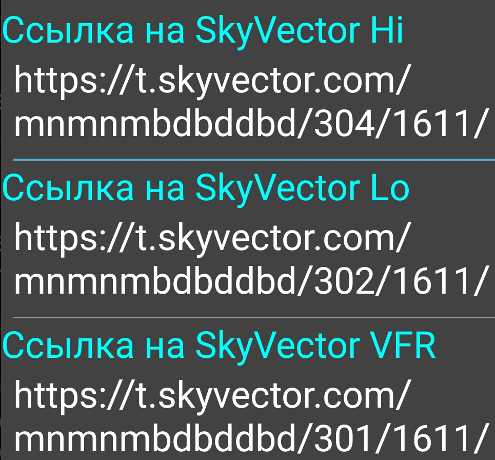

did Skyvector change the base url? My usual adjustment of the tile folder is not enough anymore to download the VFR charts.
Is it now t.skyvector.com/tiles/301/1607/ ???
Any advise is appreciated.

Postby Onuff » 12 Nov 2016, 04:04
new references for
