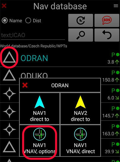

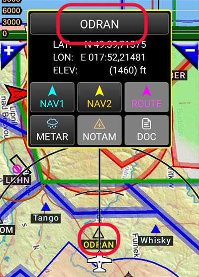

If you want to use vertical navigation to the desired WPT you must do this:
1. Find the WPT in the Navigation database. For example tap WPT at the map, then tap at its name
2. Click at the WPT icon at the left side.

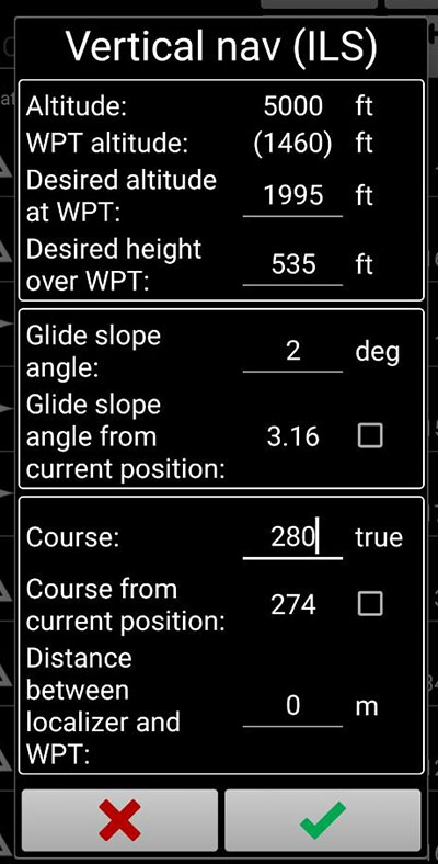

4. Fill the Vertical nav dialog box.
