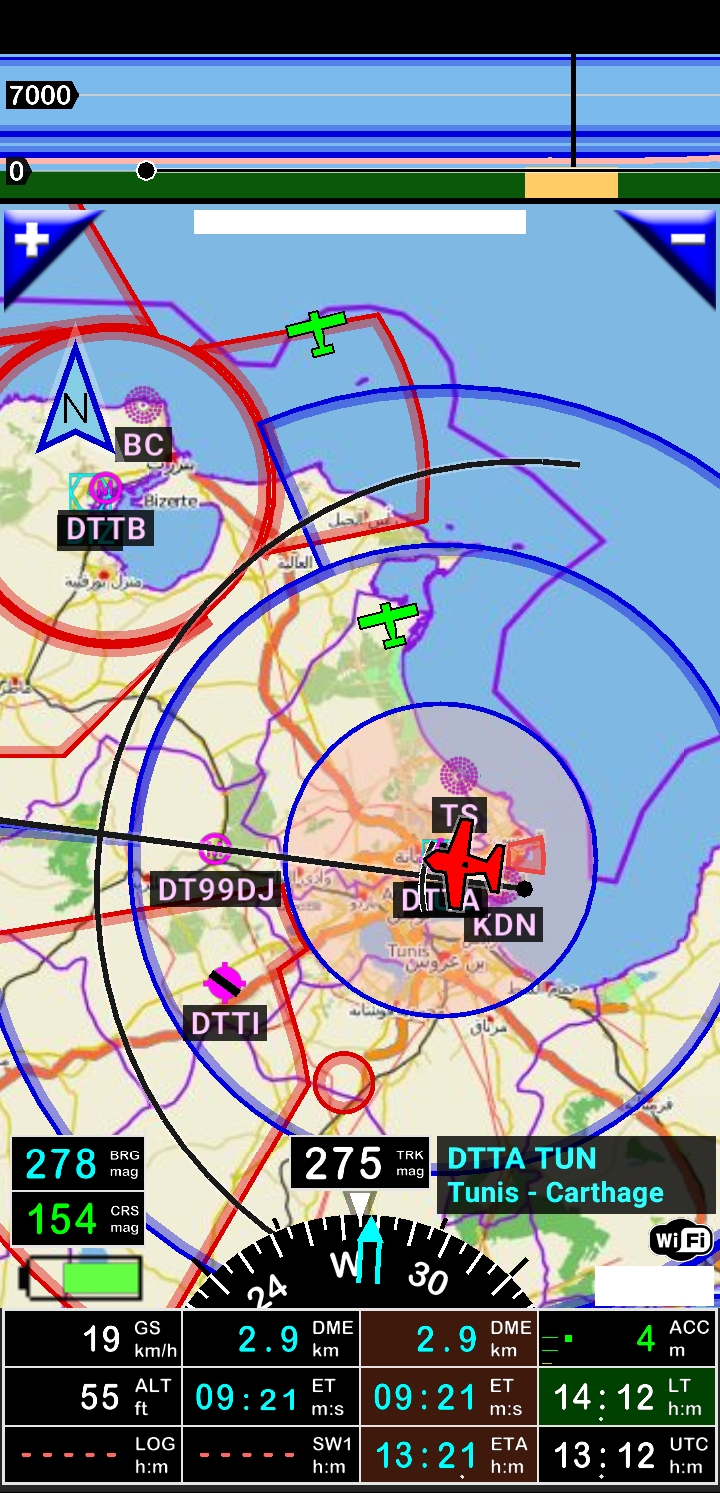

Postby Tonio » 10 May 2019, 22:32
Today in Tunis, where I leave, being close to Tunis Airport, I tested ADSB-In using Stratux with Fly Is Fun
It works well !!!
Congratulation Petr
For those that already have a Stratux, the way to proceed is the following
1 – Start the Stratux until you get the green light
2 – on your Android device
- Wifi network chose “Stratux” (you may have to disactivate data connection)
There, you can check with your web browser if its work
- Launch Fly Is Fun
3 – within Fly Is Fun, make sure you can use the Stratux
Short press on the compass rose
Then select “Application settings” -> “Preferences” -> “External data source” -> “Wifi” -> “Stratux”
Within “Stratux” page, select “Use it”
Then back to moving map screen, where you can see aircrafts being around
Just great
For those that doesn’t have a Stratux, you can build it your self in less than 1 hour http://stratux.me/#parts-list for around US$ 150.- or buy one ready to use http://stratux.me/#pre-built-units for around US$ 240.-
Have fun and send some screen copies

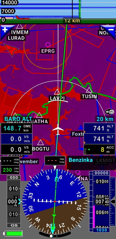

Postby kitercuda » 20 May 2019, 19:23
- The artificial horizont is displayed only when Stratux has GPS fix.
- You can calibrate AHRS by long pressing the slip indicator at the bottom of the screen.
- If you want to see some information, tap the aircaft symbol.

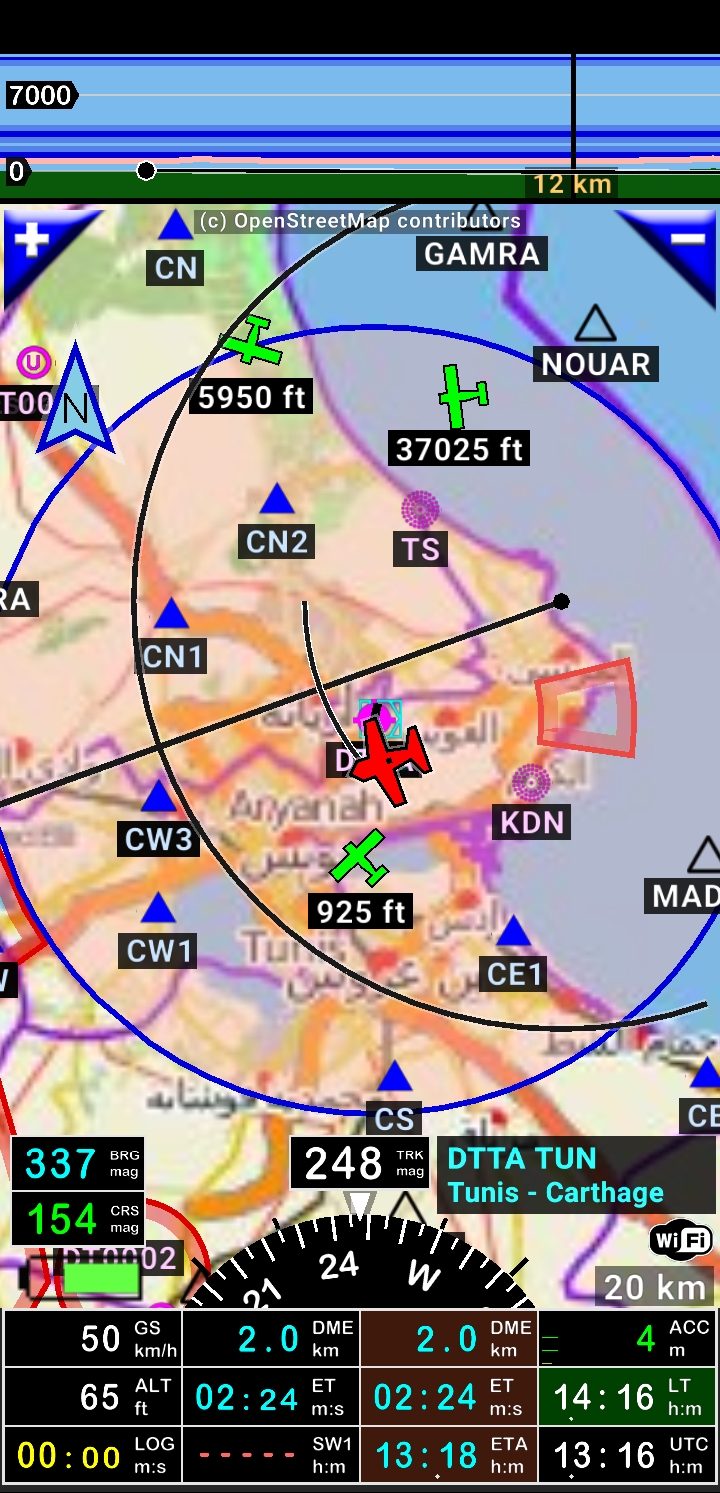

Postby Tonio » 09 Jun 2019, 10:18
What you get for less than US$ 300.-
FIF and Stratux AHRS-2019-05-12 22.11.54.jpg (121.13 KiB) Viewed 18501 times
FIF and Stratux ADSB_20190510_141614_gps.jpg (129.2 KiB) Viewed 18501 times
