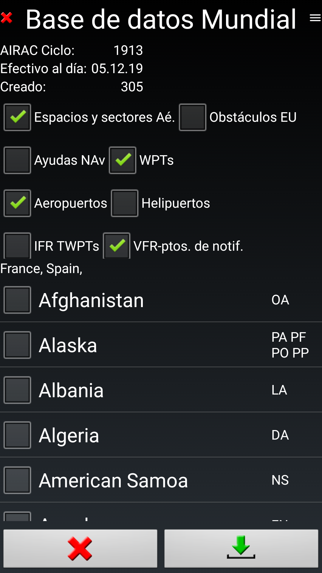

Postby Eliseo » 10 Oct 2019, 10:38
Hi Petr
The aeronautical data in my country have always been mixed with those of the ultralight,
now I observe that the heliports are also together.
Can each category of aerodrome be solved and separated?
If I can help you tell me. Thank you
Eliseo

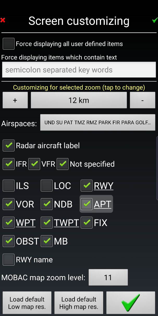

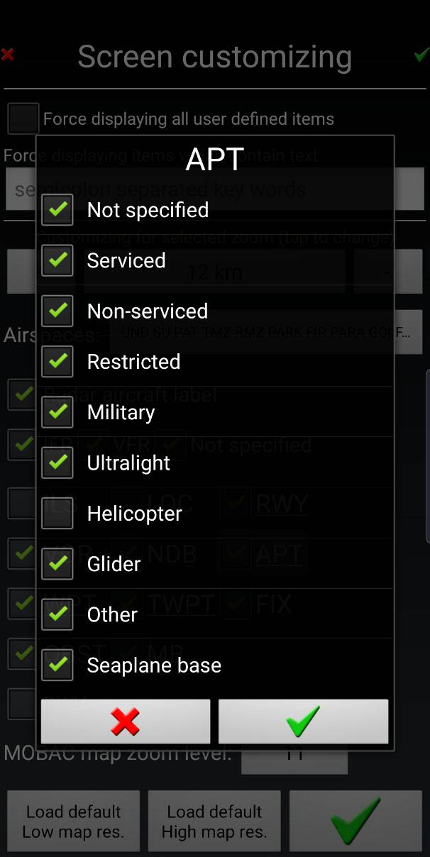

Postby kitercuda » 20 Nov 2019, 19:02
Open Screen customize - long press the compass rose or Menu / Application settings / Customize screen
Now you must do the instruction for each zoom separatelly!
- Select zoom
- Long press APT
- Check / uncheck desired APT type
- Press OK

I know the operation of the FiF quite well.
Look at the photos, input when under the data I do not select the heliports and these if they go down, then we select them in "Screen costumizing" as well as the ultralight and if they appear on the screen.
I remind you that in general the aerodromes that do not start with LE in Spain are Ultralight and it seems that they can not separate from the airports this issue we already touched on years ago and possibly I did not understand enough, I hope to fix it now, because it really is a Important problem.

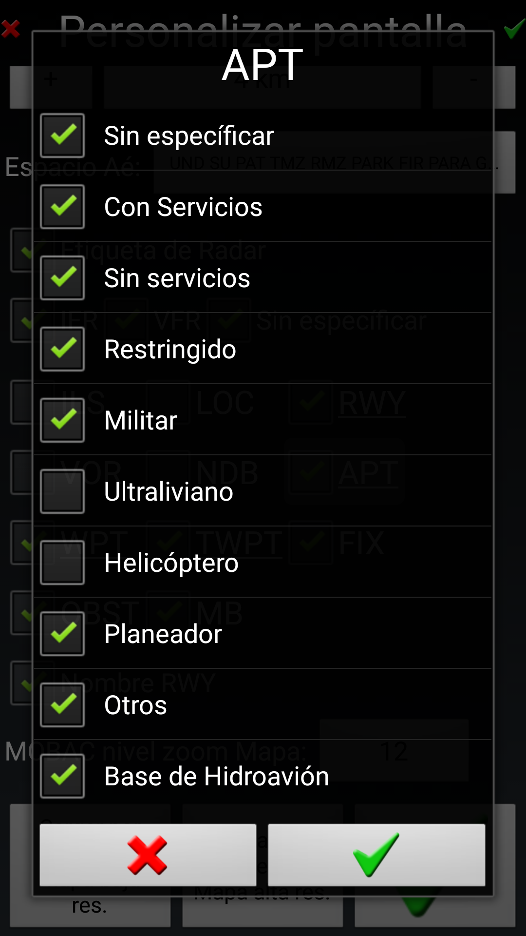

Postby Eliseo » 29 Nov 2019, 17:37
more photos.
ULM
Screenshot_20191129-180729 (2).png (386.11 KiB) Viewed 15399 times
Helicopters
Screenshot_20191129-180601 (2).png (480.09 KiB) Viewed 15399 times

Postby kitercuda » 01 Dec 2019, 16:40
Thanks Eliseo. I will rerpair it. I ty to do it today or tomorrow. Some heliports are not marked as heliports.
You will need to import the database agaim.
Re: Base Datos España
Postby kitercuda » 01 Dec 2019, 18:35
Repaired. Please download the nav database...

Postby Eliseo » 02 Dec 2019, 11:12
Thank you very much, can the same be done with ultralight fields? All flight fields that do not start with the letters "LE" should go in the ultralight section.
Cheers.
