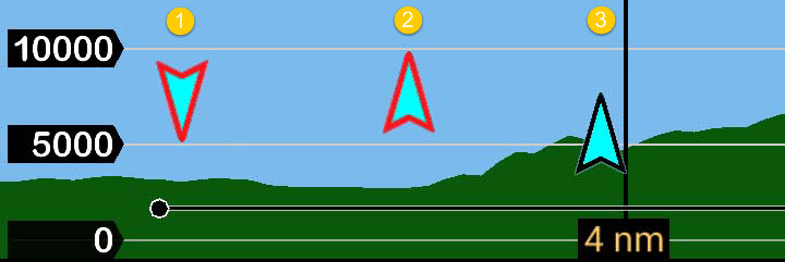

At the Moment, is shown in the Verikal view the planned height of the flight plan as a down arrow.
Unfortunately, we can specify no Minimum or Maximum altitudes in the flight plan. On the Attached JPG, a proposal is presented.
1). Waypoint Maximum 5000 ft
2). Waypoint Minimum 10'000 ft
3). Waypoint 7500 ft (Standard)
It would be helpful if this feature would be implemented.
(New Attribute on .gir example: <wpAltitudeMinMax> )
