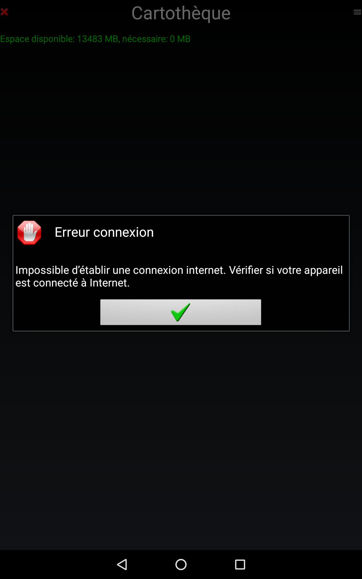

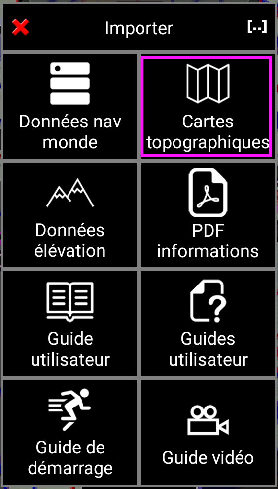

I report here a small bug happening when importing a user map:
Compas > Import > "Topographical Map" ("Carte Topographique" [fr])
Import is prevented by an error message "Connection Error".
Without internet connection, I expect to be able to access at least the maps already imported and import menu for user map.
In my use case, the map is already loaded in the tablet so I do not need an internet connection either.
Děkuji
[EDIT 06/082/018] : Problem can be circumvented by taping outside the warning message box.
If you click/tap OK, FIF restart and you cannot select another file to import
If you tap outside the message box, this one disappeared and you can select files and proceed to importation

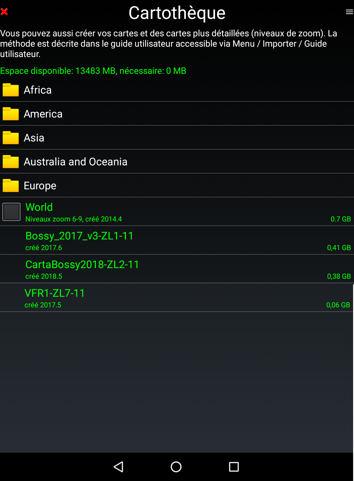

Postby Tonio » 11 May 2018, 11:15
Dear Farly / Děkuji
According your screen copies, your maps "Bossy_2017_v3ZL1-11, CartaBossy_2018_ZL2-11, VFR1-ZL7-11" are in the right folder and in the right format. That's why you see them in green.

1 - “Import” function requires an active internet connection
Import function allows i) accessing remote Fly Is Fun server, ii) displaying data/maps available on Fly Is Fun remote server, iii) importing data / from it.
Without Internet connection, you can’t connect to remote Fly Is Fun server, that for it is absolutely normal to get the “Connection error” message.

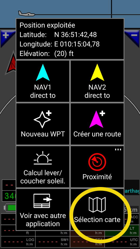

3 – To select the map to use with Fly Is Fun

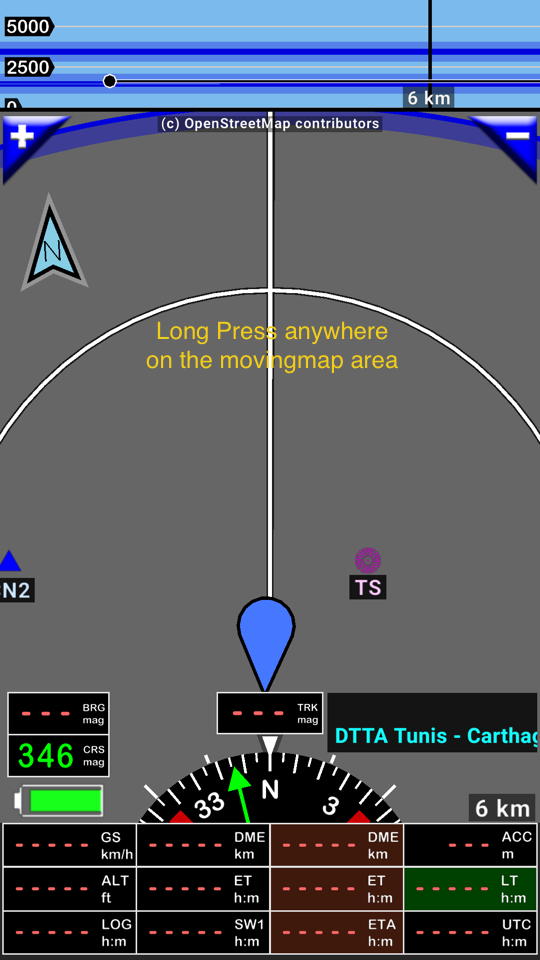

- Start Fly is Fun and go to that “Moving Map” screen
- Being on “Moving Map” screen, long press anywhere on the map part (grey area, if there is no map displayed in background).
- An 8 buttons palette popup.
- Select “Map selection” (bottom right)
- Map(s) that is available, in the right format, in “RMapSQLite” folder is/are displayed
- Select the map to use.
